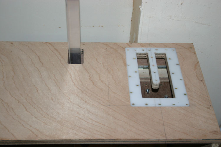

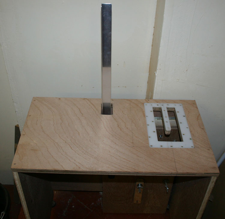

I had a version I put together in a hurry and loved it, but having had the experience of using it, decided I would do the design justice by making a proper version, I have just finished it, so here are some pics.
Paul once again, thank you for sharing this design.

Looks good Russell. Do you cut the proper angle on the neck heel before you clamp the neck into your jig?
PostPosted: Fri May 19, 2006 12:03 pm
Hi John
First of all I should emphaise that the concept for the jig is Paul Woolsons and he as I understand it adapted in from a design by Charles Fox.

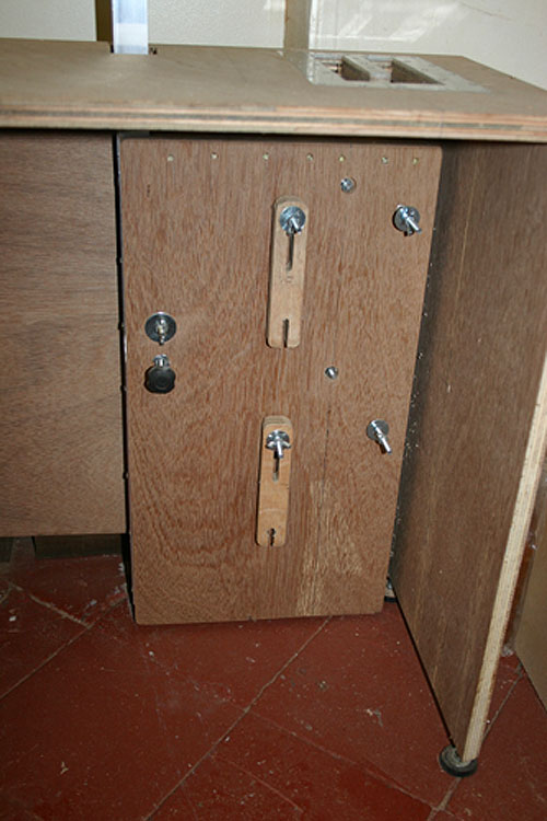

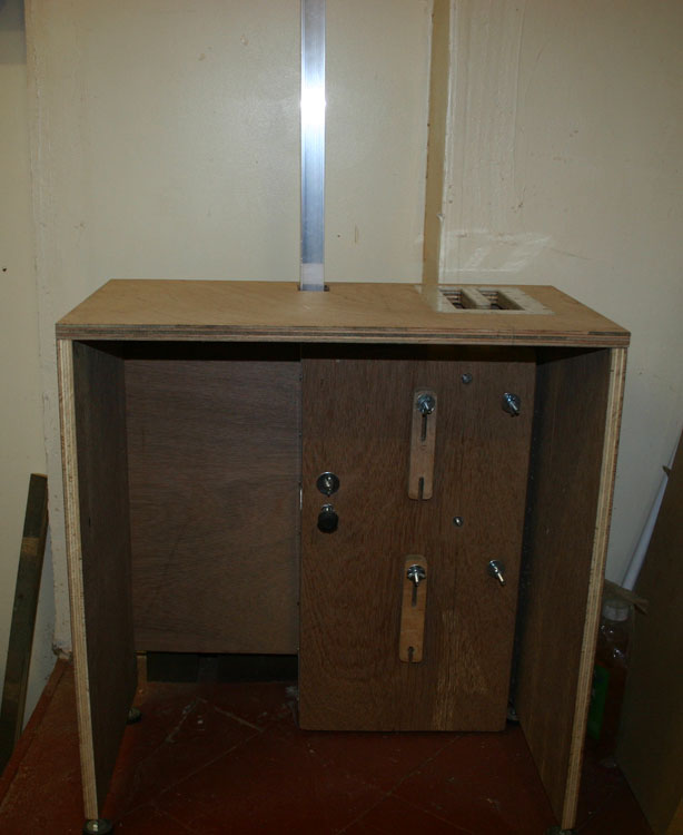

The neck is square when the little studs sit in the truss rod slot to align the neck to the center, you then put the body against the straight edge which is sticking up and adjust the black nob below until you have the desired clearance at the Saddle position, the silver wing nut above it locks everthing in place. Then you route using a guide bush and thats it you have you neck angle cut for you to the correct angle, I use a downcut spiral and the neck cut is clean and fits exactly, just a tiny touch with fine paper to refine the fit.

Okay, I think I finally get it.
The aluminum shaft is attached to the base which is vertical. That vertical base is adjusted to the guitar body, which is sitting in position on the top of the unit.
Adjustments are made until it fits the body. Then, the neck blank is inserted in the holder and routed to whatever adjustment was necessary to fit the body. Pretty clever. Why didn't I think of this?
